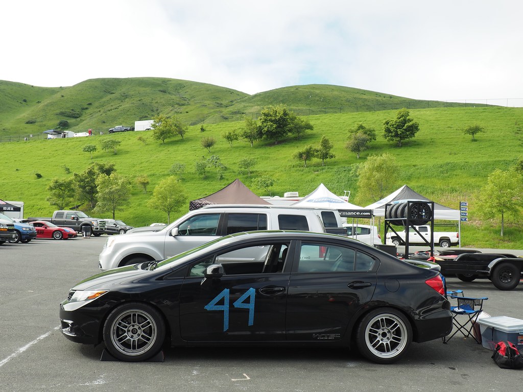

This is my +35 setup with 255/40/17 up front. It fit, but JUST barely. As I said early — I'd recommend running a square 235 all the way around if it's your daily driver and you're looking for a rotatable setup. Let me know if you have any more questions.

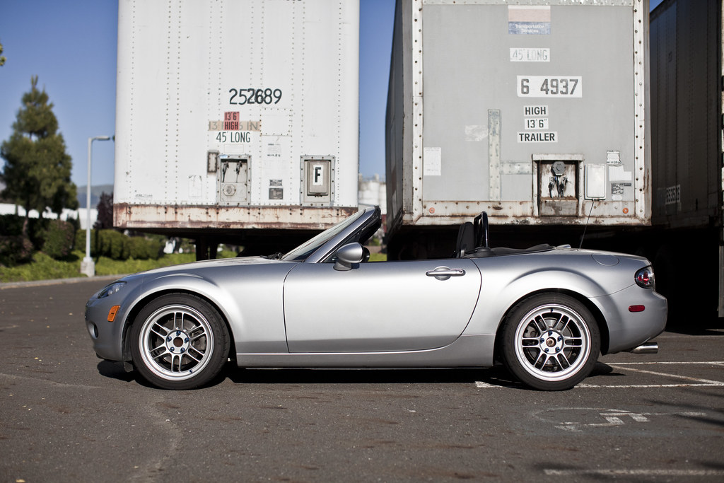

These are 17x9 on a Miata. Just know that due to the design of the wheel, the rpf1 tends to look smaller than it really is due to the lip design. So with a 16", you'd be an inch smaller than how this looks.
LOL -- this is my old miata! That was a 17x9 +45 with 235's all the way around
