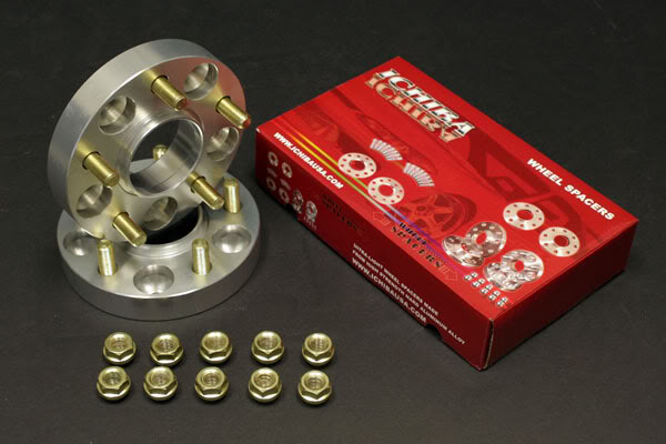

if you get thick spacers, you're losing threads to keep your lug nuts secured properly. It can get to a point where you have to use something like below which holds your rims on securely.

I have 5 mil spacers and there's still about an inch gap. I would recommend 20 mill spacers, but then you need to get extended studs or the type of spacer pictured above. If you are lowered though and you want your wheel to sit flush with your fender you will most likely need smaller stretched tires and your fenders rolled.

Also, say you buy a 15mm spacer. Your stock studs aren't long enough so you need to buy extended studs and have those put in. If you don't want to do that, then you can get the ichiba v2 spacer with the studs already attached. Except..... your wheel will hit on the stock studs sticking through and you will have to grind them flat. Either way it's a pain. Also grinding your stock studs means you cant just take the spacers out and go back to stock. You'll have to buy new stock studs and install them.
