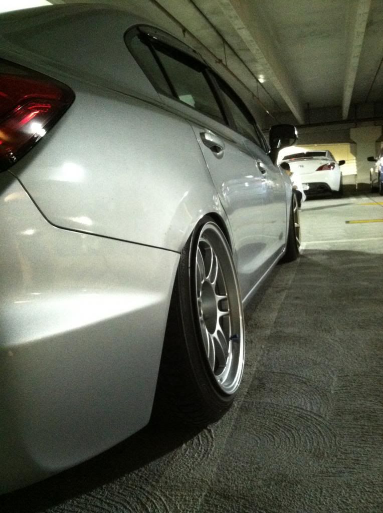

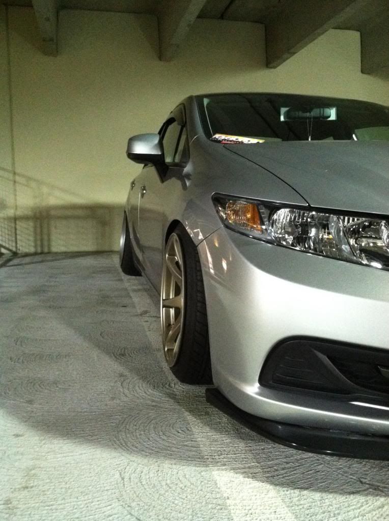

Been a while since I updated. Its been the same set up and nothing really has changed. I did sell my old battles and got new wheels today to try out how aggressive of a wheels I can fit. Ended up picking up 2 mb battles in 17x9.5 +15 (with a 3mm spacer) and 2 enkei rpf1 in 17x10 +18 and put them up. the result? Perfect :)
