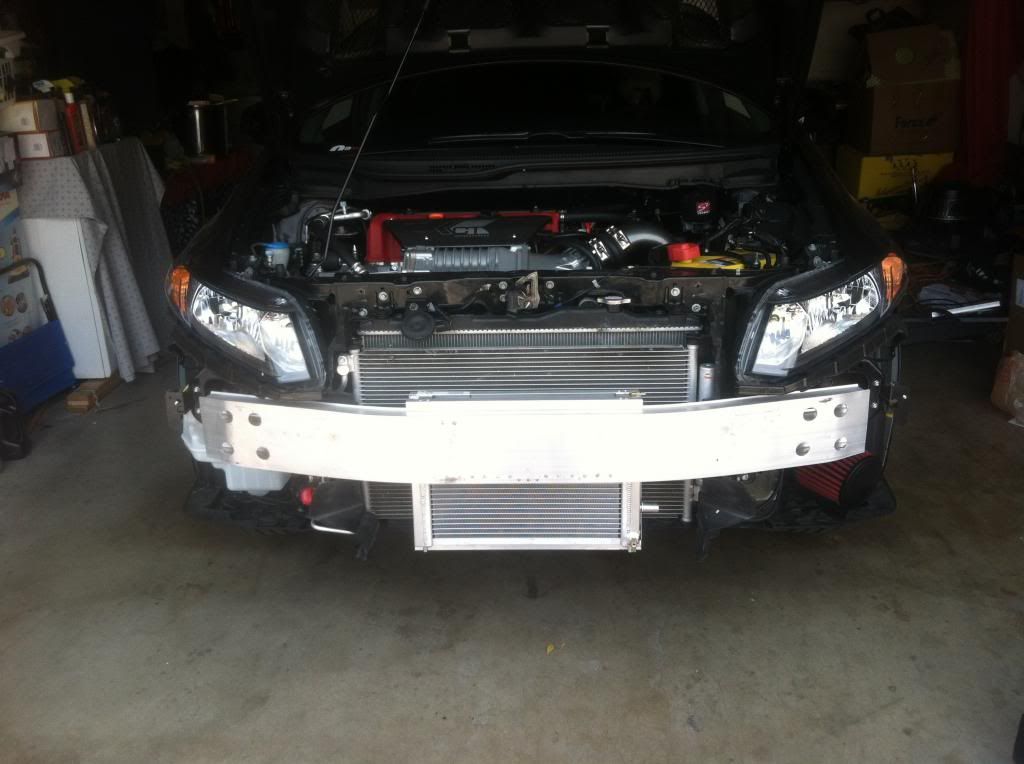

I built a cradle out of aluminum angles, square rods with rivets and brazed it all together. I ended up bolting it to the crash bar and supporting the bottom from the AC condenser support. Here's a picture of it while I was mocking it up.
