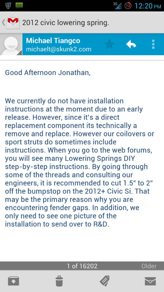

Well skunk2 asked if I had cut my bump stops cause your supposed to when you install them, anyone else had to do these when installing aftermarket lowering springs

Well I was doing some research and seems like other companies require or even give you a template to cut the bump stops

Yea I hope I'll get as low as you once I cut the bump stops, just waiting on skunk2 to get back to me about how much of it needs to be cut.

Coming from skunk2 directly.
