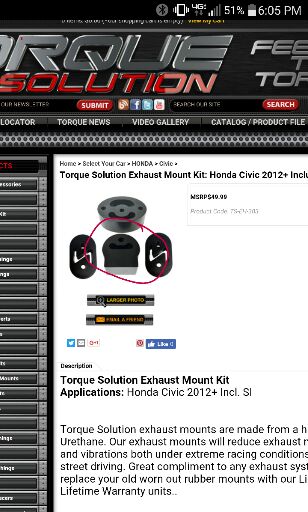

Hey for the torque solution hangers there is one with a flat bottom and a round top the one in the middle of the picture do you know where that one goes?

@tsalmeri3 The top is for the rear of the muffler the bottom is for the muffler itself and the ones on the sides are for the midpipe and downpipe, I acutally have a set of 2 of the midpipe and downpipe hangers if you're interested in them they're new.
