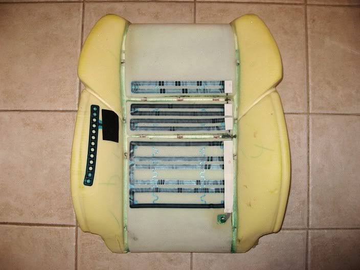

On the passenger side you have to deal with the OPDS (Occupant Position Detection System).
Ever noticed the light that says passenger airbag on or off based on the weight on the seat? Yeah, there are a bunch of sensors in that seat.

These are the OPDS sensors in the seat bottom for 8th gen civics and 04-08 TSX:
