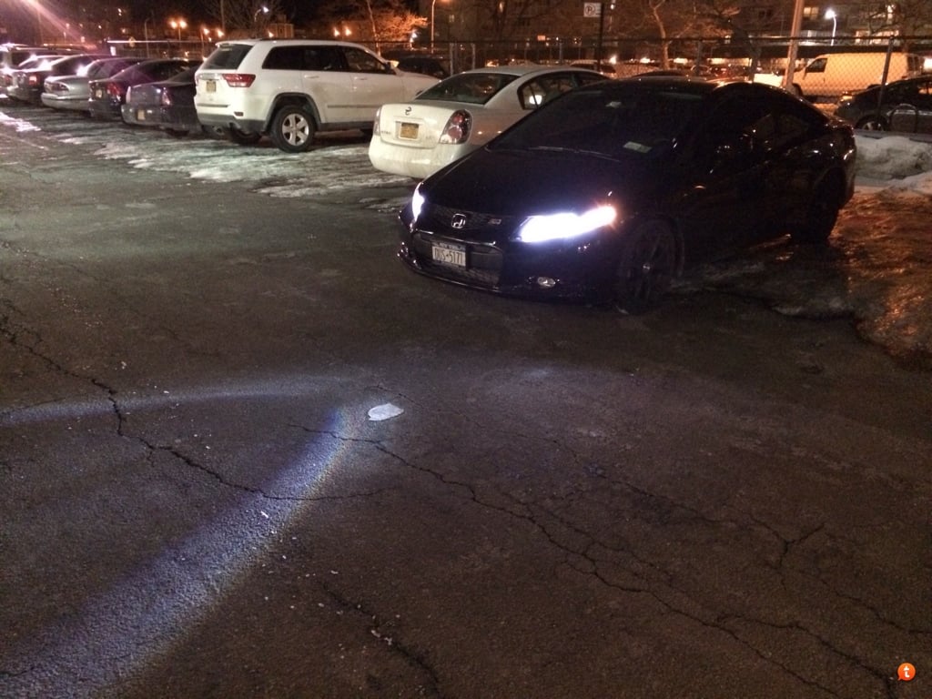

I made a picture today in the afternoon while looking at it with a friend and we did notice that in fact the projector probably like webby said, is not meant to be used with HID Xenon Kits, in the following picture
And its really clear that those 2 black lines and the big bright spot in the middle are the bulb of the xenon:

Im going to buy a good set of halogens first, test it out and see if the lighting are improved, if they dont, I will end up buying a pair of hid mini projectors and pay someone to put them on.

Hey bro I have these headlight as well and hids just installed them and the beam pattern for me is horrible nowI had the same problem. But I fixed it. I turned the HID bulbs 180 degrees and problem solved

( so ima try and fix it today but what you mean you turned them 180 degrees don't they only go in one way?Dude I tried this and I worked but I hope my hids last long in there like that!!I had the same problem. But I fixed it. I turned the HID bulbs 180 degrees and problem solved

Yea it sucks.....like really badYea I tried flipping min as we'll bit they just don't sit right.. There's only one way that the bulb can fit nicely in there..
