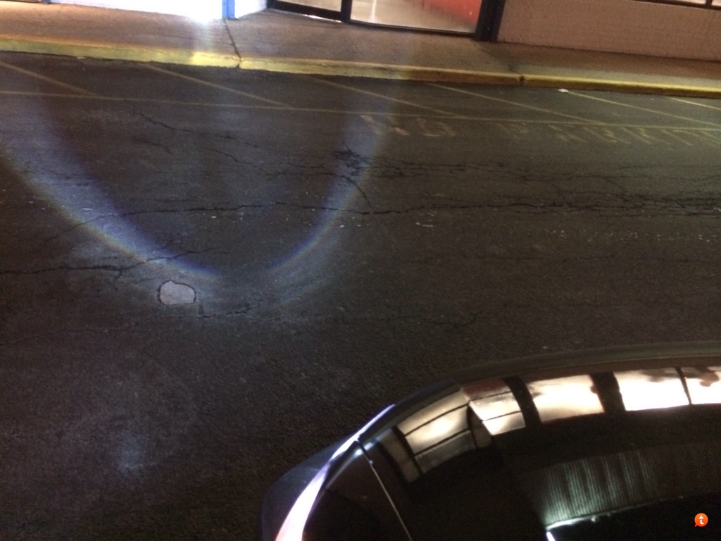

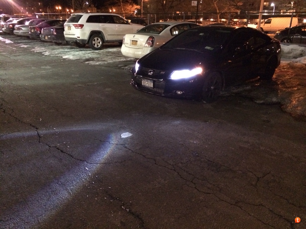

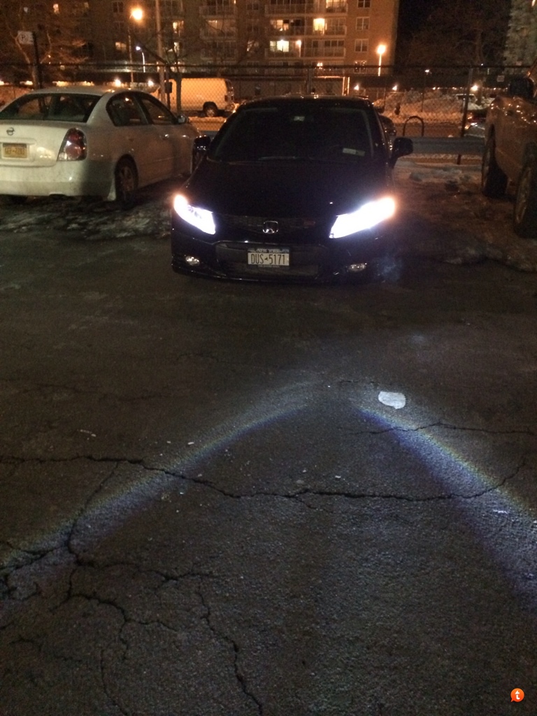

Hello guys,
I bought from amazon this projectors and install a pair of xenon lights on them, they are H1 bulbs, now im not sure but the result of these are not what I expected but the place where I got the damn Xenon lights are telling me "thats how it should look, the problem could be your projectors", Im wondering if you guys can tell me what is the problem by looking on this pictures, this is the result, as you can see the ground and the lighting is weird, its creating 2 circles in which the middle of the circle is not covered in light, could this be the xenon lights? or do you guys think that the projectors can handle a Xenon Kit? the projectors I got are from http://www.specdtuning.com/

and the result of adding Xenon lights:
What do you guys think I should do? or what the problem could be?

That's the result of putting HID bulbs into a projector housing made for halogen bulbs. The reflector bowl on the projector is not designed for HID bulbs, so the light output will not be the same. The bulbs/hid kit are not to blame. Others have had this same situation come up. You either have to live with the output that way, or use halogen h1 bulbs.
it's not the lenses... it's the chrome reflector bowl that causes the issue

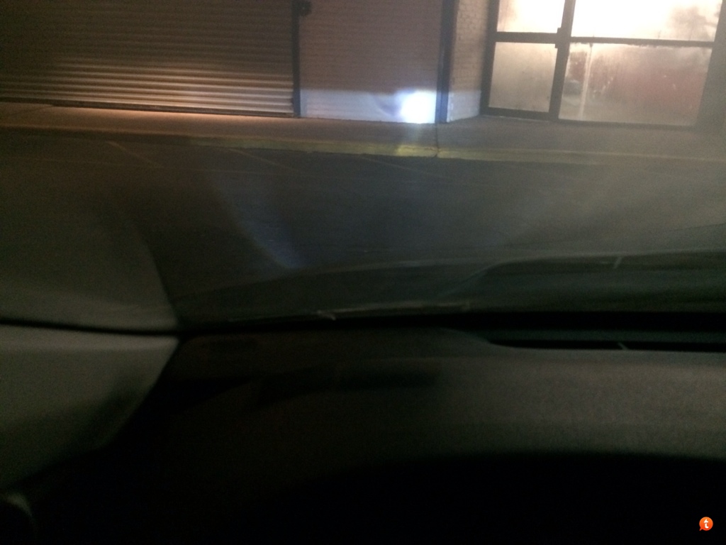

I made a picture today in the afternoon while looking at it with a friend and we did notice that in fact the projector probably like webby said, is not meant to be used with HID Xenon Kits, in the following picture
And its really clear that those 2 black lines and the big bright spot in the middle are the bulb of the xenon:
