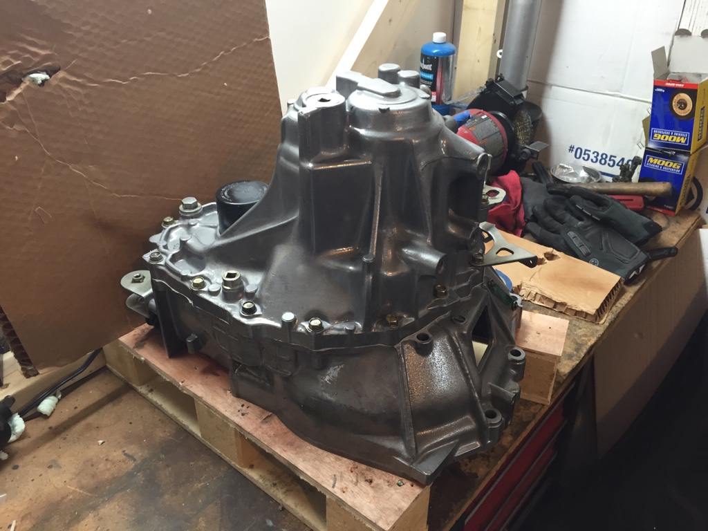

Found this thing just floating loose inside the transmission case.
Also found the source of the leak in my tranny. Waiting on a new axle deal before I put it back together
Its the spring from the passenger side axle seal. The seal tore and it fell off it seems.
Installed my new clutch yesterday and closed up the transmission. Tried to put it back into place by myself but just wasn't strong enough.
Does it literally rub against the transmission? Exhaust looks super close.
It is vey close. There is just enough room to remove the dust cover on the backside of the flywheel. No rubbing though.

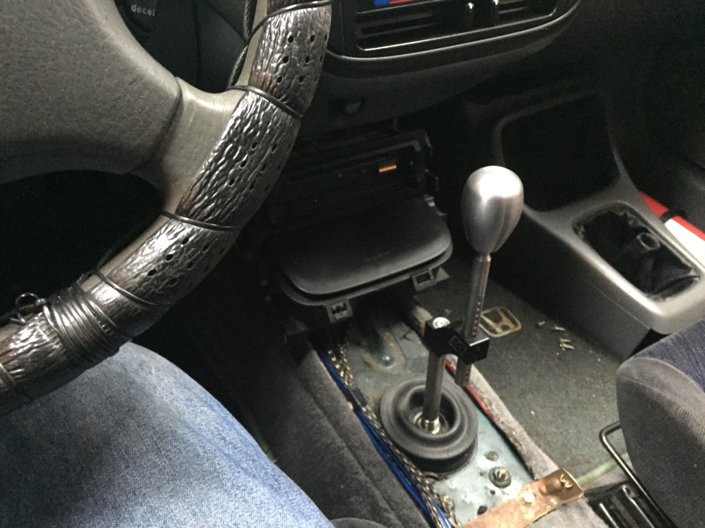

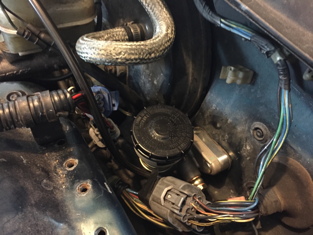

Other net goodies include a Ktuned adjustable shifter. And blox s200 clutch master cylinder with good ridge braided clutch line.
Took it for a little shakedown before work today and it literally felt like a new car. The clutch is extremely stiff though. I will not be driving this car in traffic that's for sure.
