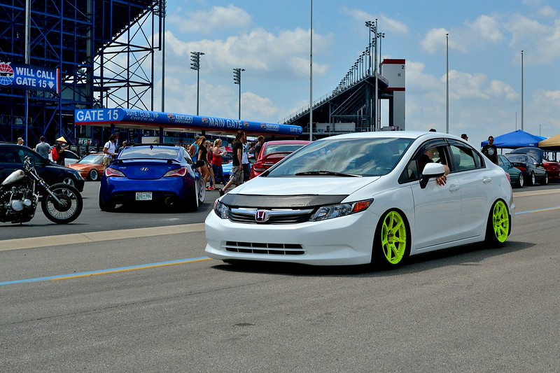

I was thinking about getting some springs and wheels this spring. I basically wanna look like this:
(idk who's car this is, took it off of another forum)
Im planning on getting XXR 530 17X9.75+25. The XXR527's above has the same specs with a 215/45 tire, and Coilovers. I wanna get the same look, but idk what kind of springs to get that will give my car this look^. I was originally thinking sportlines, but that seems too low, maybe H&R's? I can get camber bolts no problem, but I dont wanna do any pulling or shaving or what ever it is you do to the fenders lol. Im just really diggin this look.

That is a very aggressive wheel size you have picked out. The 9th gen does have more room in the fenders it seems like. You will definitely have to run camber arms in the rear to fit them if you go very low and run lots of neg camber. Also a 215 on a 9.75" is a pretty big stretch for that tire. Pair that huge stretch with a lot of camber and you will not have very much tire in contact with the ground.
I think an 18" looks good on a sedan also. Larger body style with a larger wheel. The XXR530 comes in an 18x8.75 in a +33 or a +20. Might be easier to fit without doing body work and without running excess camber either. You can still go pretty low with that. Just depends.
Are you looking to have that really wide wheel with the cambered out look? The car you posted doesn't seem to be running much camber at all.
This is my wifes 8th gen sedan on xxr527's in 18x8.75 +35 and she is running a 225/40 tire. Hardly any stretch at all. She is lowered on HFP suspension but we still had to do some work. Front fenders are rolled and the rears are shaved. I think that with the larger 9th gen wheel wells you could probably run this size setup and go much lower without rubbing.

Ok well here's my $0.02
Just as Nix said, that x9.75 wont make it. 1) that is a wide wheel, 2) that offset is low (sort of)
For the look you are going for, I personally would not stretch tires unless you plan on actually going low, and I'm not talking about springs. I'm all for being slammed and stretching a tire, but I also don't see the need to stretch a tire if you don't have it. Your perfect fitment for what you want to achieve, based on the pic you posted, would definitely be a x8 +35 - +30 and you can run a 215/45 safely with no rubbing. You might be able to run a 225, actually.
I understand that you like "poke" and a little low, AND THIS IS MY OPINION, but poke with wide wheels and only a little drop, is horrible.
To each their own though, please don't think I'm talking crap, I just don't want you to make your car look like its mexi-flush. If you are going to do any poke or stretch, slam it or don't stretch at all.
For a slight drop, no rubbing, here's what you can do:
- 17x8 +35 to +30 even a x8.5 ----- but anything wider than that starts to look iffy
- 215/45 tire ------> www.tyrestretch.com is a good guide to see what certain size tires look like on certain width wheels.
- You can run camber arms, but its not "necessary." With the drop you want, you will barely see any camber difference. But if it makes you feel better to run rear camber arms, then go right ahead. I use them, but they are set to the stock (OEM) length, and I'm really not running a lot of caber.
I've ran up to x9.5 wheels on my car without pulling fenders or rolling and I never rubbed. My camber was still set to stock length and its not bad. So again, running camber arms is optional. I'll post some pics to show you some differences.

Thanks everyone for replying. sk8nava, Your cars looks great! Ive had a change of heart. Im actually thinking about getting eibach sportlines with XXR 530 17x8.25+25. I figure i should have nothing to worry about with that size
will a +25 offset wheel have more of a concave look than a +35?
I still like the wide, poke look so maybe down the road ill pick up some coils and new shoes.

Wide has nothing to do with offset or concavity. The wider the wheel is, the more concave it will be. The offset wont change that. You're much better off running a +35 on that setup with such a mild drop over the +25; here's why.
The +25 is going to bring the wheel/tire out more from the hub. the Closer you are to zero (0), the more the wheel sticks out. Don't get this confused with "poke" because that is not what it is.
'Poke' is to be considered how much the lip of the wheel pokes out from the tire: I.E.; the more stretch the tire, the more the lip of the wheel shows
I know it's your car, and I'm not trying to build it for you, but I think you would be happier with the 17x8.25 +35 with 225s on them, even a 215 wouldnt be bad. I say this because if for some odd reason your car bounces or hits a bump decently hard, or you turn too fast; the +25 will be out there enough that you could rub. Even though its only a 10mm difference, its still going to make a difference when it comes to rubbing. So that +35 will sit in perfect at any height you choose and look really nice. Again, it is your car so do what you want, I'm just giving my opinion to help you make your decision. Its just so common that people want to go wide and stretch but don't want to drop the car, then they get their setup on and hate it, regret it, then are stuck trying to sell their wheels because they are unhappy. I don't wish that on anyone!
