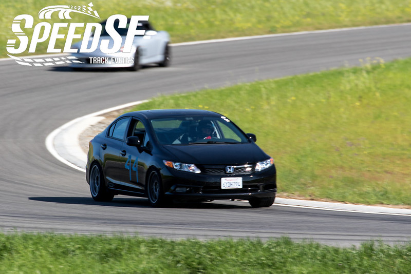

I'm not sure where you're reading that. Our cars greatly benefit from negative camber. I run -2.5* all the way around on mine, and am going for a lower offset up front in my next setup to dial in more because of some goals I've set for myself with the motor in stock form.
Biggest I've run is 255 up front. This picture is of a 255 up front with 17x9, +35et RPF1. At the time, the alignment was -2.0* all the way around. The fender had to be rolled and some of the liner cut. You will not be able to fit that 19x10 unless you really, really make body modifications, and even then, performance will be hindered. Looks is up to you.

Almost forgot! @webby Here is a pic of the closest thing I have found to what I want my car to be like in the end. So hard to find examples of flares on my model.
Perhaps my value is a bit low; that's good to know, more camber means more fitment options. Thank you for the advice and picture, I guess the 19's are but a dream unless I move to Hawaii or Oregon. The 255's, on the other hand, look great and will likely be my end tire width. I wish I could see a 265 or 275 for comparison, but I haven't found anyone running them.

More camber is more of a performance thing, but it does open up how low of an offset you can run on your car. My plan is to jump to something like a 25~20et up front. 255 is a pretty big tire depending on what tire you run. I'm running 255 because its a common setup for staggered fitment, modern Hondas, and it's also the max tire I can run for the group I am working my way up in.
