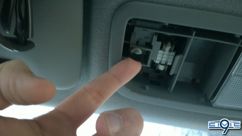

first what you will do is remove the cover. in the first picture im pointing to where you can see the clips that hold the cover in place. youl want to avoid these as not to break them.

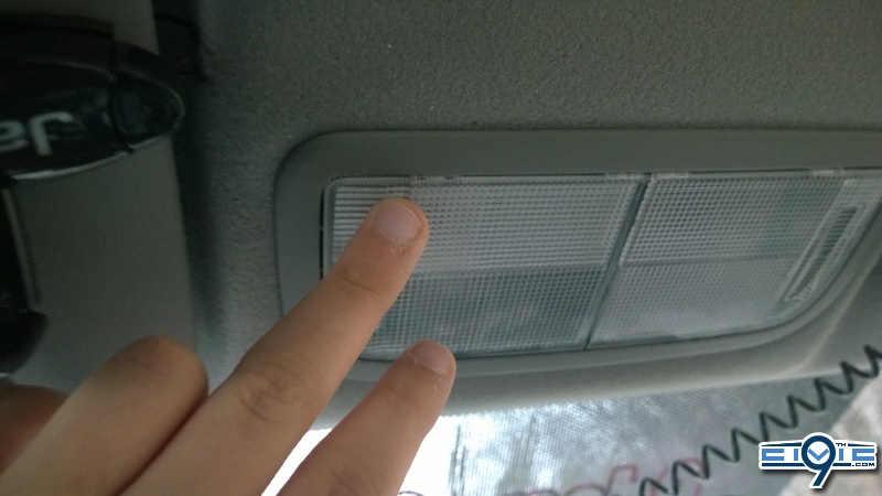

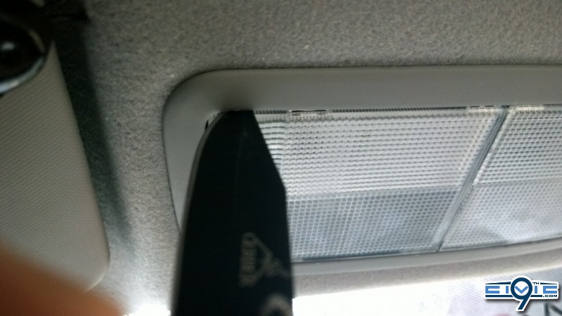

the second pic shows where i place the knife to pop it off without breaking anything
gently pop it out.

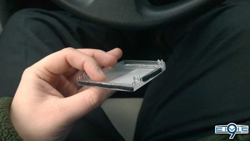

next cut two thin lengths of the velcro and apply it to the back side (facing windshield) and center of the cover as shown here. youl only want to do the center piece on one cover or else it wont fit back on (one facing the camera and side that contacts the other cover).
gently pop it out.
