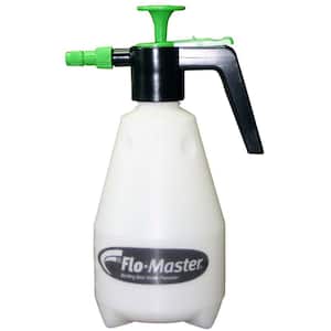

I would cover the fuse box tightly with aluminum foil and a plastic bag with a rubber band. Same with the alternator. The bike bright stuff Monk mentioned is a lot safer than a lot of degreasers you'll find at auto zone.
Like has already been mentioned, don't blast water around in the bay. Gently spray everything off. A couple good brushes will help a lot. one of those garden sprayers is pretty useful too. You can work one area at a time and they are cheap.
This is what I use for this type of thing. Its like $7 at home depot.
