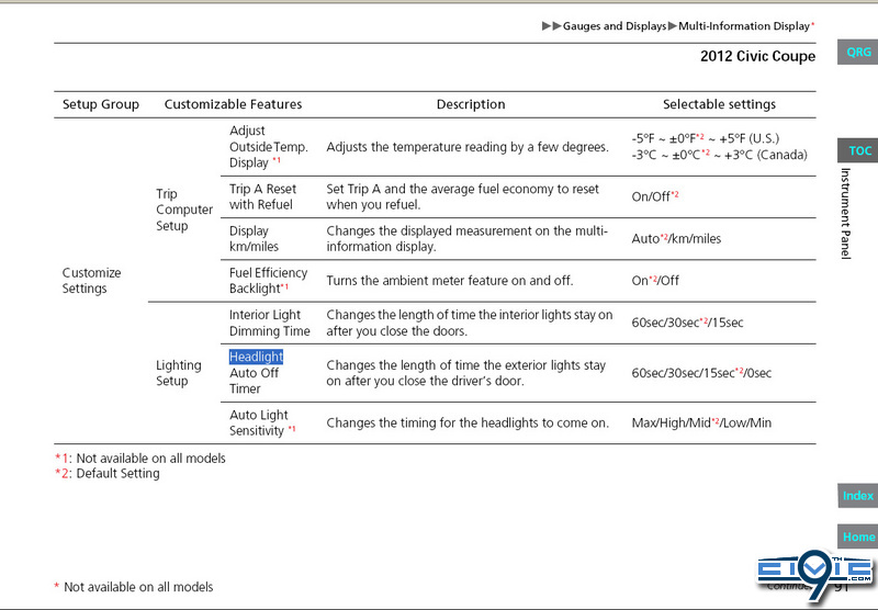

page 91 of the coupe manual - (probably similar in sedan book)
have you adjusted the sensitivity, or do you know what setting it's on? max/high/mid low/min

Just figured out what it all means in the 2012 Si
Sensitivity is just what it means - how sensitive!
Max is most sensitive "brightest"
Min is "dimmest"
There's a 5-second delay between triggering and coming on or going off. (Used a flashlight to test this function.)
With ours set on Max the lights come on if you're parked or heading away from the sun after 5 PM on a sunny day (today).
With it set on Min they stay off in a moderately shady area at the same time of day.
I still think even Min is way too bright to have the lights come on but at least I understand them now.
