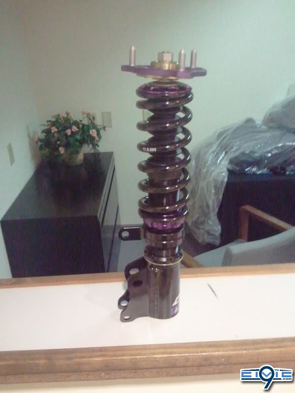

CUSTOM D2 INSTALL THIS IS NOT A KIT THE SELL FOR THE 9TH GEN !!!!!!! i finally recieved all the parts i needed to make this work heres a pic on the suspension with the link mounting on it already i bought from d2 for 50$ each comes for the fit suspension so thats where i got the idea from i didnt let them what is was for and the didnt ask either so ill keep u guys posted on the progress on the install this week

Just finished installing the suspension fit just like a glove drove like 12miles from work and it rides smooth but a lil bumpy just like i expected but no noise at all pics up in a few

only this i had to grind because it was a lil to big for the control arm
this hold the lowering part of the rear on to the control arm

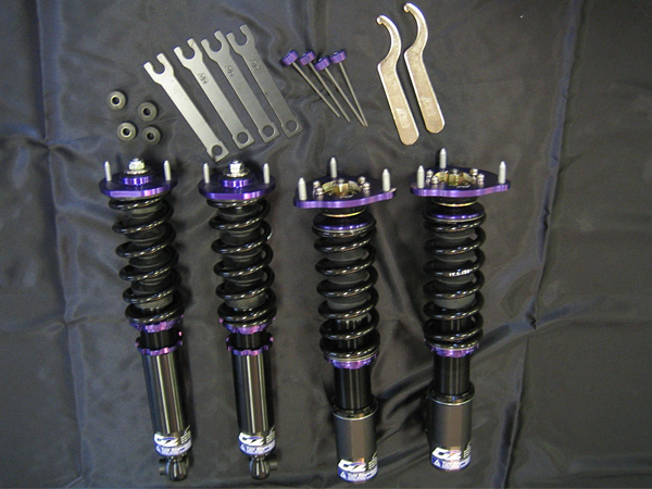

ok, I'm still not sure what all has been used? Are these 2006+ (8th generation civic si) D2's that you're using?
part # -
http://www.collegehillshondaparts.com/honda/rubber-rr.-spring-mounting/52691-sna-a01-honda/
need 2 of these?? ^^
main parts needed for install apart from suspension
what is this from - how many needed?
sorry for so many questions, but people are going to want to know how to replicate your setup if it works well... and see how much it costs etc...
thanks for any info

$875 06 -11 civic d2 suspension
50$ link mount didnt come with part number just called and sent a pic i found on the net, two needed
$36 shipped 06-11 civic rear insolater
part # -
thanks for any info
webby no these are not the ones i used

Those "links" that you found to make the swaybar work....where did you get those? Very interesting.
Chris
bought them from d2 they come on other kits like the honda fit and the for tiburons i found it just google stuff up
