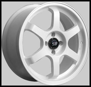

Hi everyone, i recently joined this forum because i have a friend that joined from 8th civic and he says its great. I have a 6th gen ex coupe. I recently bought a set of rota wheels off of craigslist and now i cant find hub centric rings that will fit. i took them to a local shop to have them measured and appriently they have a strange outer diameter. According to them, they measure at 56.1mm hub, and 64mm for the outer diameter for the wheel. Anyone out there know of websites that would carry these? Or should i remeasure to make sure that they measured correctly? Hopefully i can get some answers on this forum, because the last one i belonged to didnt seem to care. Thankswheel rota.jpg
Oh and just curious if anyone could tell me the model of rota wheel this is by the picture?
any chance for a pic of the back of the rim... some stamping info may be on there. They remind me a lot of rota grids, but the face of those look more rounded.

are you sure those are rota they look different look at the valve stem on webby picture the valve stem lines up with the bolt in your pictures the bolt and valve stem don't line up...
my pic was just the closest thing I could find to his wheels... I'm guessing those are just some style they made years back and no longer produce.
I double checked with a second email with Rota and the guy just sent me back an email saying "yes" meaning he's positive it's 67x56.1 lol taking a shot in the dark I'll update when I receive them
