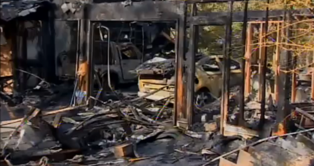

No one was hurt – but two plug-in vehicles were destroyed – in a fire in a home in the Connecticut town of Barkhamsted last night. The cars were a brand-new 2011 Chevrolet Volt with just 2,000 miles on the odometer and a converted all-electric Suzuki Samurai that the homeowner, Storm Connors, converted himself years ago. At this early stage, it is impossible to tell if one or the other vehicles was the cause of the blaze – or if it was one of the charging systems or the garage's electrical system – but firemen who responded to the 911 call said that this is one angle that the investigators will look in to. Local news channel WTNH reports that Connors, "likes his cars too much to think having them charging in the garage started the fire." Another news channel, WFSB, says that, "fire officials suspect an electric hybrid car may have sparked" the blaze.

looks like the volt is burnt much more than the suzuki.

Our engineering experts have inspected the Chevrolet Volt severely damaged in a garage fire in Barkhamsted, CT. We believe the findings indicate the Volt was damaged by the fire, not the cause.
The garage and its contents, including the Volt and a hand-built Suzuki Samurai EV, were heavily damaged in last Thursday's fire.
While the Volt's battery pack sustained damage, it was not extensive enough or of the type that would suggest that it caused the fire. In addition, there is clear evidence based on moderate damage to the cordset and charging system that neither component caused the fire.
