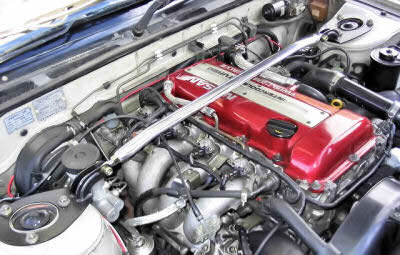

If your car had struts that were sitting out on their own in the middle of the wheel well like they were on older cars this might be a something to consider:
