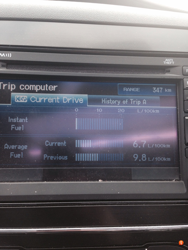

Now that weathers better. I was getting on average 12L/100km. no highway all city with -20 weather. It was at 8•c when I got the 6.7L/100km. Best I got without having a pic was 6.1L/100km. No Idea what that is in miles.

12L = 3.17006 GAL \ 100KM = 62.1371 Miles = 19.6 MPG
6.7L = 1.76995 GAl \ 100KM = 62.1371 Miles = 35.11 MPG
6.1L = 1.61145 GAL \ 100KM = 62.1371 Miles = 38.56 MPG
I think that's correct
Thanks bro. I'm useless with the conversion to mpg. But I understand the mpg better than the L/100km
