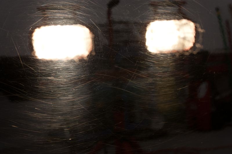

Most dealerships and high volume shops have the workers running rotary buffers with wool pads and they never follow through with all the required refinement steps, resulting in holograms everywhere.

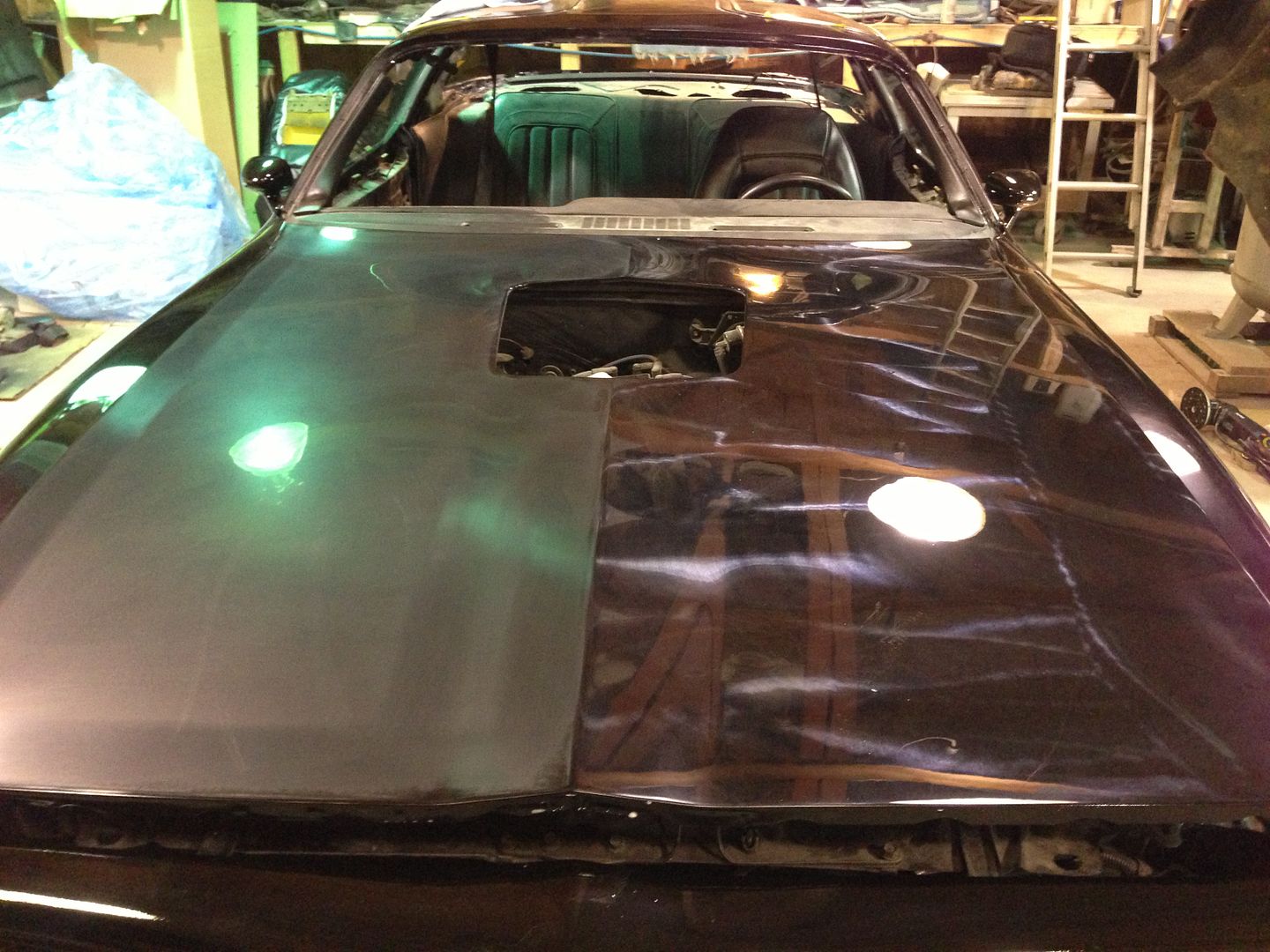

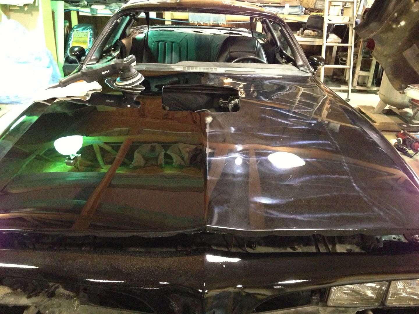

Example...(extreme)
This car was painted and wet sanded 6 months ago. The right side of the hood is how it looked after the body shop compounded out the wet sanding marks....full of nasty holograms!

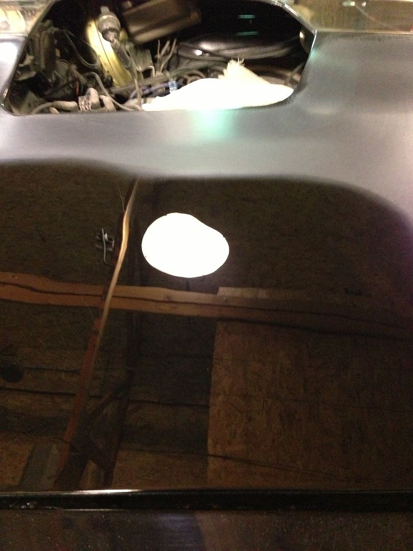

The paint has since shrunk down a little and still had a little more orange peel than the owner wanted. This weekend I re-sanded the left side of the hood and compounded out the sanding marks my way...
One more polishing step and the paint was like glass! ;)

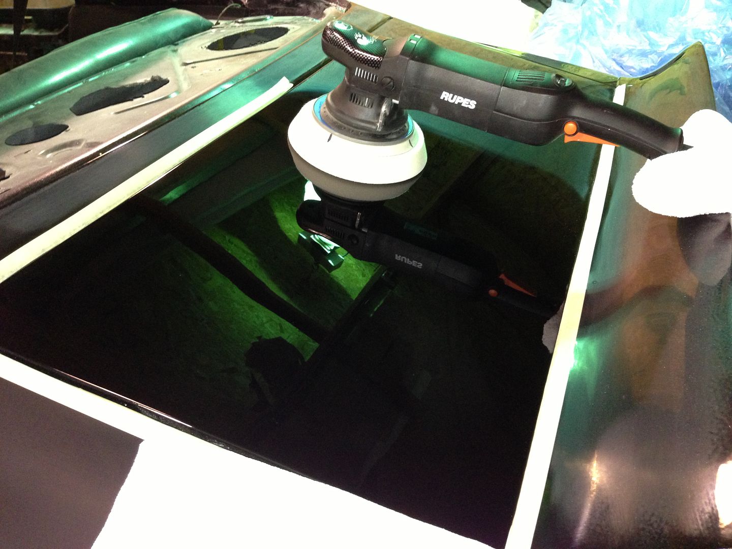

Griots/Porter Cable/Meguiars dual action polisher
A backing plate 5" (the velcro disc so you can attach the pads to the machine)
The 5.5" pads are a good place to start, the 6.5" pads are too much for the machines to turn and are trickier to control. the 5" is a nice balance.
6 pack of 5.5" pads
Polishes: Meguiars 205, Menzerna PowerFinish 2500
Wax/Sealant: Collinite 845, Chemical Guys Blacklight (top with wax & CG Hybrid V7), Chemical Guys XXX wax, Blackfire Wet Diamond
All easy to use.
I would stay away from the kits and just get the items you need. It comes with a 6" backing plate but you may want to buy a 4ich plate and pads as well for the hard to reach areas.

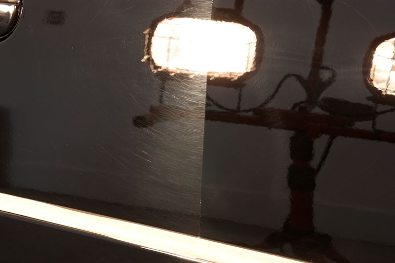

I like LC pads, I use the Hydro ones more than the traditional, but either will work. Hard to say what you'd need without seeing the paint, but what Nix suggest will improve the finish for sure. If you can post pics of the finish i ndirect light I could make better suggestions. Be sure to the camera focuses on the surface too...if you don't have a camera with manua focus you can place a pice of masking tape on the paint for it to auto-focus too.
Example:
50/50
