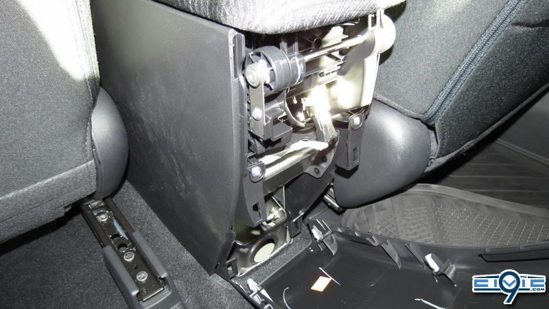

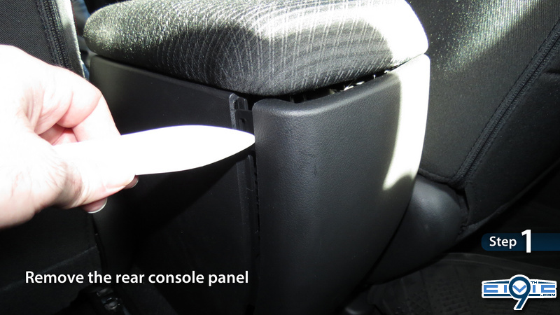

  1. Remove the rear console panel.
    The panel is tightly fitted with six retaining clips. My recommendation is to use something smooth, round, and pointed at the end. A dash removal trim tool is what was used here.
    Note: Using a sharp tool is not recommend as it can damage the panel.

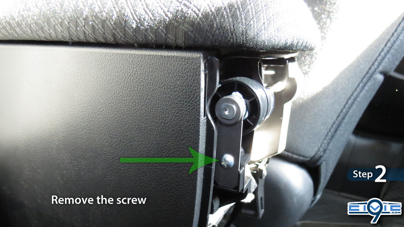

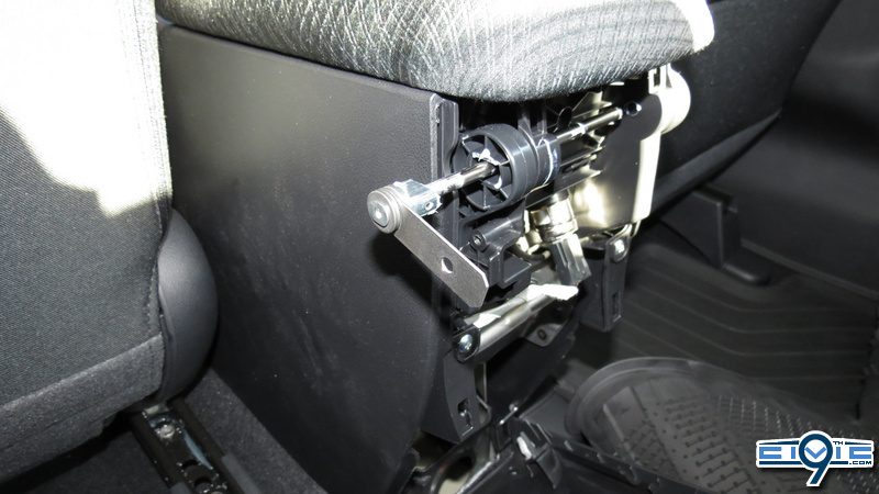

  2. Remove the screw.

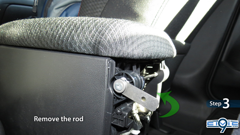

  3. Remove the rod.
    Turn the metal tab counter-clockwise, then pull the tab towards you to remove the metal rod.
    Place the rod onto a shop towel to keep the grease from getting onto your hands and upholstery.
    The Armrest Assembly should now lift of with ease.

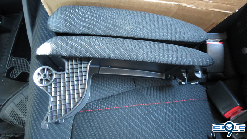

  4. Remove the excess mounting bracket from your new Top Coat Assembly.
    To do so, remove all five screws (green arrows), then use your dash removal trim tool to push inward a mounting clip (blue arrows), as indentified in the photos below. The clips are in-between the fabric and the bracket. You only need to push one in, then the entire bracket will come loose.
    Note: Honda included two mounting brackets with the Si; one attached to the Top Coat Assembly and one attached to the Hinge Assembly. You only need one bracket.
    I do not know if Honda included it by accident or not, so I'm going to assume that this is standard operating procedure.
  5. Attach your new Top Coat Assembly to the new Hinge Assembly.
    Sorry, no photos for this step as I forgot to do so; however, you probably don't need one anyway.
    It's difficult to show you exactly where and how to line up the bracket with the Top Coat, but you should be able to eye it out. Although you won't hear any clicking sounds to indicate a firm connection, you'll know you have it seated correctly when you can no longer use your fingers to separate the bracket from the Top Coat.

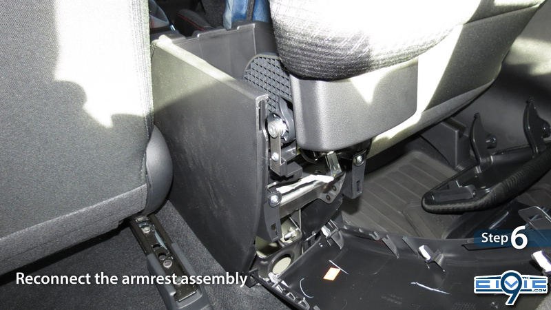

  6. Reconnect the armrest assembly.
    Reinsert the Armrest Assembly back into place in the center console and line it up with holes where the rod will go.

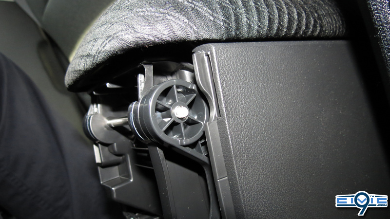

    Reinsert the rod and be sure to push it as far inward as it can go. You'll notice that the end of the rod with the metal tab has an oval-rectangle joint that must align with the same-shaped joint on the Armrest Assembly. Once you have it aligned and fully inserted, push the metal tab back into it's original position and mount the screw.
    You'll know you have the rod correctly in place when you can see it on the other end as shown in the second photo below.
    Note: It is easier to reassemble the rod when the Armrest Assembly is closed.

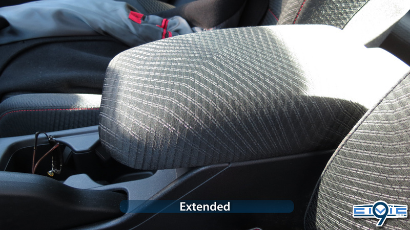

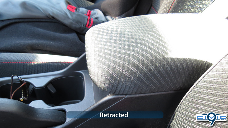

Here are a few photos of it installed in its retracted and extended positions.
And here is a photo showing the size difference between the old and new armrest. The old armrest is at the bottom.
Photo showing the design difference between the old and new rear console panel. The new armrest is at the bottom.
